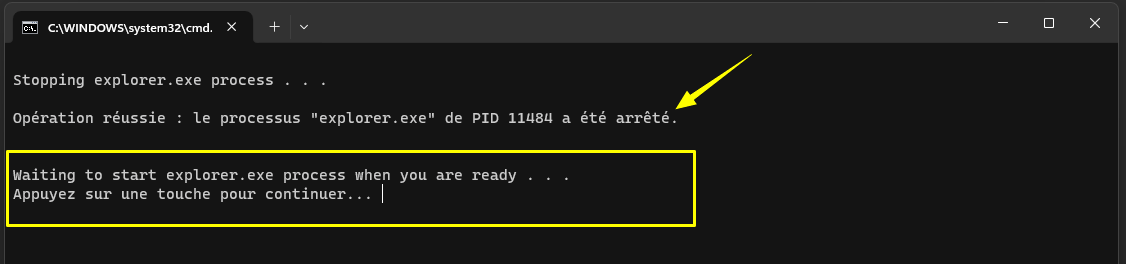

Ajouter Redémarrer l'Explorateur avec pause au menu contextuel du bureau
[-HKEY_CLASSES_ROOT\DesktopBackground\Shell\Restart Explorer]
[HKEY_CLASSES_ROOT\DesktopBackground\Shell\Restart Explorer]
"icon"="explorer.exe"
"Position"="Bottom"
"SubCommands"=""
[HKEY_CLASSES_ROOT\DesktopBackground\Shell\Restart Explorer\shell\01menu]
"MUIVerb"="Restart Explorer Now"
[HKEY_CLASSES_ROOT\DesktopBackground\Shell\Restart Explorer\shell\01menu\command]
@="cmd.exe /c taskkill /f /im explorer.exe  & start explorer.exe"
[HKEY_CLASSES_ROOT\DesktopBackground\Shell\Restart Explorer\shell\02menu]
"MUIVerb"="Restart Explorer with Pause"
"CommandFlags"=dword:00000020
[HKEY_CLASSES_ROOT\DesktopBackground\Shell\Restart Explorer\shell\02menu\command]
@="cmd.exe /c @echo off & echo. & echo Stopping explorer.exe process . . . & echo. & taskkill /f /im explorer.exe & echo. & echo. & echo Waiting to start explorer.exe process when you are ready . . . & pause && start explorer.exe && exit"
